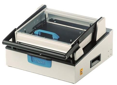

A vital part of the WireFlow test-system framework is the fixture that we have selected. It is a solution from Ingun and is depicted in Figure 2.

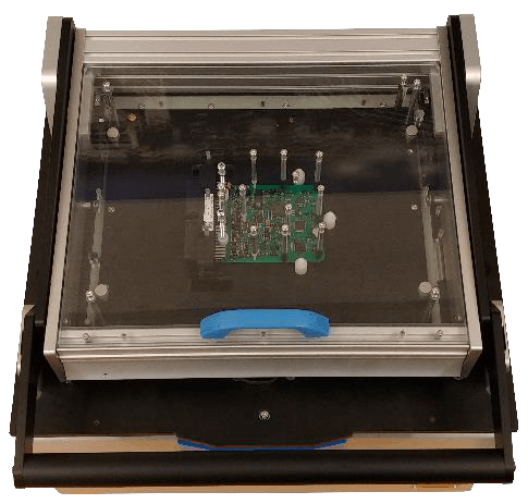

The Ingun fixture is modular and separates the test instrumentation located in the box (or “I/O-box”) at the bottom, from the DUT mounted in the so-called cassette at the top, just under the hood with the blue handle. The two parts are interconnected via a standard high-density connector. The whole fixture and the interior of the I/O-box is all part of WireFlows framework. The only thing specifically developed for the client is the cassette, i.e. the board that mechanically attaches the DUT to the fixture and electrically connects it to the I/O-connector. Everything else is to be considered ready-made, or rather, ready-designed.
If later, our client wishes to introduce another DUT, whose test specification is compatible with the test instrumentation in the I/O-box, they only need to design a new cassette. Signal pin-out is defined in software.
 Figure 1. Fixture box
 Figure 2.
Test object mounted in the cassette

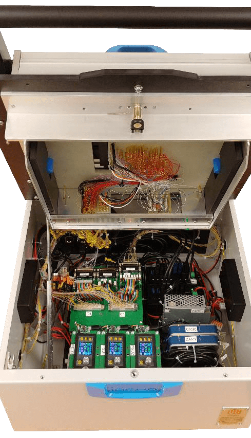

The test hardware
The I/O-box contains the following instrumentation:
Manipulation of digital signals and measuring analog signals
This is handled by a multifunction data acquisition board from National Instruments controlled via USB.
CAN communication (2 channels)
Handled by two USB-CAN interface devices, also from National Instruments.
JTAG programming
To program the three CPUs residing in the product there are three separate USB devices for parallel software loading.
Programmable power supplies
3 programmable power supplies for independent sourcing and simulation on DUT interfaces. Controlled via USB.
Solid state relays
There are several high and low current solid-state relays. These are WireFlow’s own design and part of our framework.
Signal conditioning boards
WireFlows own design and part of our framework.
USB-hub
To connect all the USB-instruments inside the box.
Figure 3.
Instrumentation in the fixture-box
This setup, mounted in the I/O-box, is a generic design, owned by WireFlow, and is an off-the-shelf product.
It has been designed and dimensioned to have the ability to test most circuit-boards unless there any extraordinary properties like, for example physical dimensions, extreme currents etc.
The box allows for customization, so if a product has an interface not included in the standard setup, it can be complemented with support for, for example:
  • USB
  • Ethernet
  • Wireless
  • Etc
In Figure 3 you can see the interior of the I/O-box with all test hardware mounted. On the bottom of the opened lid you can see the underside of the cassette.

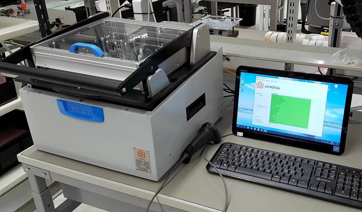

Figure 4 below shows the whole setup delivered to our client at their manufacturing site.
Figure 4. Complete production tester setup with fixture to the left, hand scanner in the middle and the controller PC to the right.
