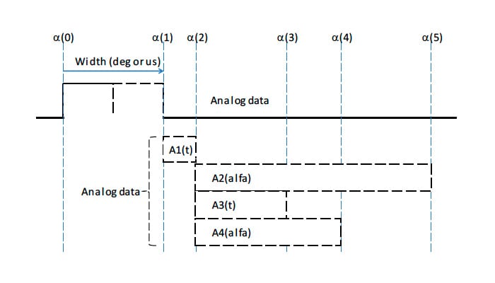

During development, it is important to be able to exactly control all parts of the ignition, like spark position and duration for each cylinder for a number engine cycles – representing a specific startup behavior or mimicking a faulty behavior.

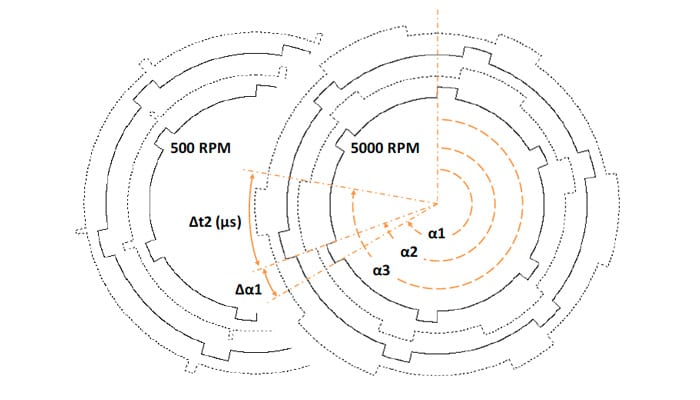

One of the tricky parts is that spark duration can be given in CAD (0.01 degree resolution) or given as a fixed time (0.1 ms) depending on engine type, whereas spark position is always given as a position (CAD) in the engine cycle. In the figure to the left, a fixed configuration for four DO channels are shown for two different engine speeds.

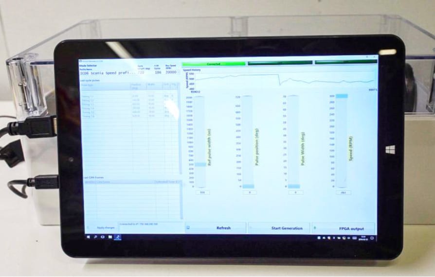

Using LabVIEW and a high end cRIO from National Instruments™ WireFlow created a system that allows the technicians at SEM to select predefined engine cycles using a touch-screen. The user can also manually control all aspects of the ignition cycle, including position and duration of each ignition pulse as well as the reference pulse using different slider bars in the GUI. It is also possible to manually change the RPM value while maintaining the pulse characteristics, i.e. the position and duration regardless if it is given in time- or CAD-domain. The system consists of four main LabVIEW components,

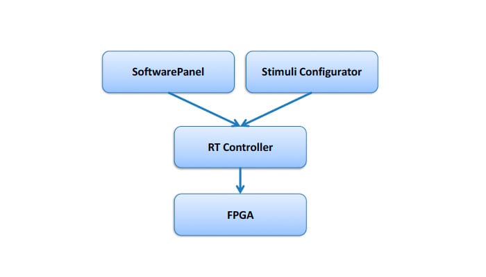

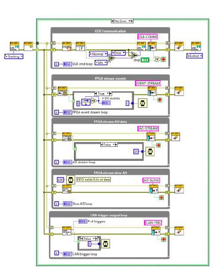

- The FPGA
- The RT Controller
- The Runtime control GUI (pictured above)
- The Stimuli Configurator GUI
